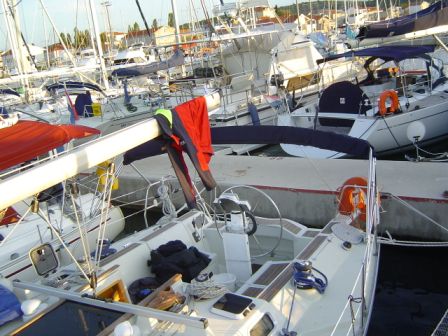

Dear Ernst and others, thanks for your wellcoming words. As you may have seen from my previous message, there are two different series of SAS 39, the one with the engine in the salon table (until 96) and the one with the engine under the stairs (97-02) and the price should also relflect this. I mean, you can get the older series with engine in the table for € 40.000 + (year 91) and the models with the engine in the back realisticaly start from about € 53 up to 70 +. The difference in the price is also because on the later models the quality of interior was much better and besides maple wood interior they offered also others (mahagony, teak, cherry) - attached is a photo I made of the boat from 2002 in teak, looks very nice to me. Also, on later models they repaired the imperfections of the earlier models, such as they installed reinforcements between hull and deck, increased the tanks for water to 360 l, etc. The price also varies because between 91- late 95 there was no production in the shipyard because of the war (Zadar was heavily bombarded for 4 years). When the war stopped, they immediately restarted the production and during the 96 and 97 they were installing the equipment that they had on stock from before the war. That equipment was new and not used, but the models were already 5 years old when they installed it. If one wants to buy the 96 and 97 SAS this is a very good news beacuse you can always push the price down on the account that the engine and other equipment is older model then the boat, etc. I think therefore that, depending on the condition, 40-48 is a fair price for models up to 96, that 52-58 is a reasonable for models 97-98 and from '99 the price goes up to 65 and more. If you look at what sort of boat you can get for this money, you will see that even for a Bavaria worn out by years of chartering you would have to pay some 20.000 more. The designers of SAS (J&J Design) basically copied the interior arrangement of SAS 39 on Salona 40 and 37, a 20 years younger boats (see pictures) which proves that designers belive that SAS 39 had some good and avantgarde fetures. I hope this anwers your question. Best wishes, Bojan
